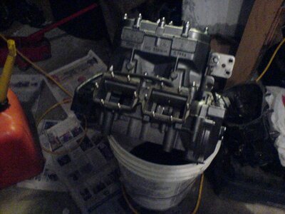

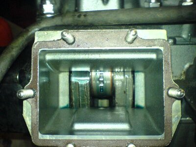

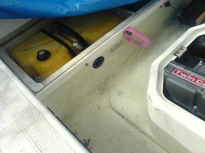

Wow .. crazy .. I have two jetmates one with no engine and one with .. both were wrapped tight and the one with engine better and had extra precautions.. of couse the oe with no engine was bone dry .. my other well a picture tells a thousnds wors so here goes ..

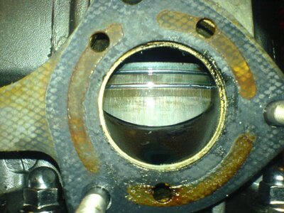

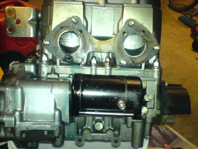

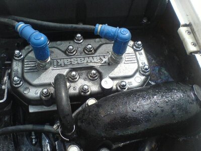

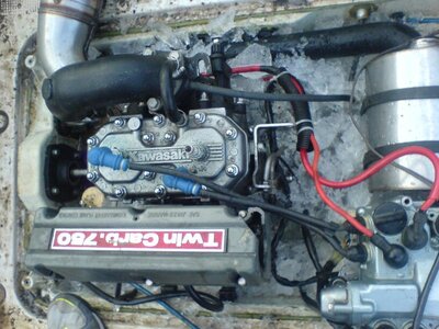

droped in a 750 last summer fresh crank and top end .. top end ran low comp guess machine show bored to large was at 120 when installed .. well after pulling yea i may have saved it .. i is now about 115 a side .. hopeull it goes up when warmer .. or maybe ( i hope ) my cheap ass tested reads way low LOL ..

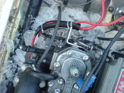

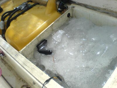

If you have a jetmate store it IN a garage LOL . !!
or at least loosen the hull shaft bearing and move forward to allow water to get out ! :frown:
