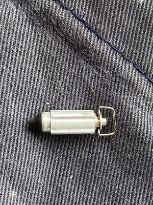

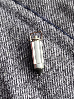

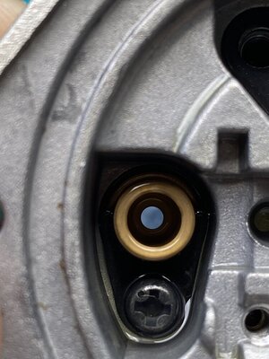

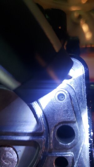

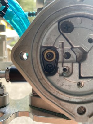

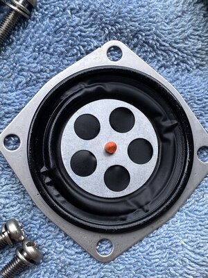

Took a few picture here’s the 2 diaphragms, I may or may not have found the problem and I will let y’all know in an hour or so when I can get them back on. Pulled both sides of the carbs apart and I was kind of surprised what I found. The passage way was almost completed clogged between the needle valve/seat and the inner filter. If this doesn’t correct it I will be getting a genuine rebuild kit from Chris at JetManiac. I appreciate all the great info!

the clogged passage could definitely cause your problem your describing. was there plenty of fuel behind the diaphram when you removed it? if not then that is most likely your issue.
check you havnt swapped the return and feed lines ?
Bottom feeds that are in the tank are hooked up to the bottom inlets on carbs, return is on the top nipple so they’re on correctly. I just got them back on the ski and still I do not see any gas coming out of the high/low pin holes in the carb body when turning over. I tried manually choking it and will still fire over when primed. The diaphragms don’t look terrible in the pics above but maybe they’re no good anymore?
There was in one diaphragm when I had them taken apart the other was still dry.
If the one that was dry was the one with the clogged seat that's most likely your issue. The 46s have a weaker signal than 44s so you have to run a lower popoff and that usually means larger n/s. Especially with the open filters. I think you got it figured out. I'd put it back together and see how it runs. I can see a big difference between the seats in your pics
