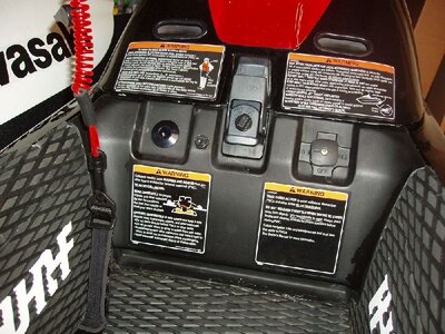

for flatwater people, removing the hood is no big deal.
although i agree removing the switch is dumb.
i have read that some people do it to reduce total fuel line volume, they were saying it gave better throttle response? no idea to the truth of that and i'm sure 99% of us would never notice it if it was true.
:woot: :woot:
yes!!! it DOES make a differnce......
i too am petcockless :27:
since I only run single carbs, I take the reserve switch out of all my boats...maybe I have a good mental clock, but I can pretty much tell how much fuel I have by how long ive been riding...
as far as the throttle response...
the most dramatic effect I have noticed is actually on my 650 stocker....Iremoved the reserve switch so the fuel doesnt have to travel all the way thru it (where it IS restricted) and now only have 2 feet or so of fuel line that the gas has to travel...
now, im not talking the differnce between 150 and 185 psi type of throttle response, but definatly NOTICEABLE and more crisp
and for the love of god do NOT put the bilge outlets so they shoot into the tray ESPECIALLY if you have internal fuel fill...
someone who shall remain nameless
borladuck: ) sold me a boat that had the damn outlets into the tray.....that ******** was so damn slippery after EVERY fuel up...
finally I got smart and got a couple of 45 degree outlets and problem solved...
