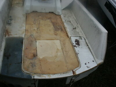

Not that I know of , but this is as far as I have gone with my b-1 flattop LOL ., Daytona and winter got in the way . BTW I like this build thread , it is top notch IMO . Great work !
