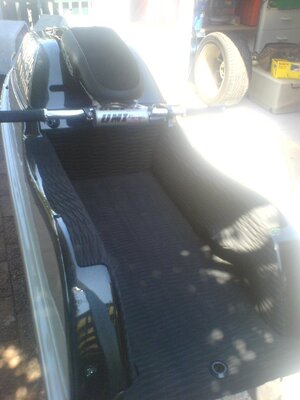

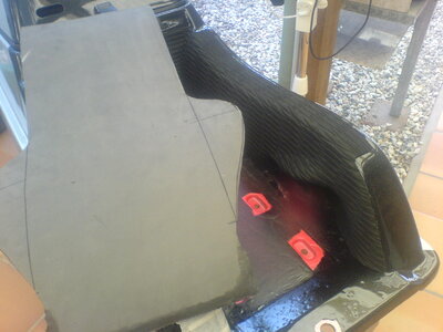

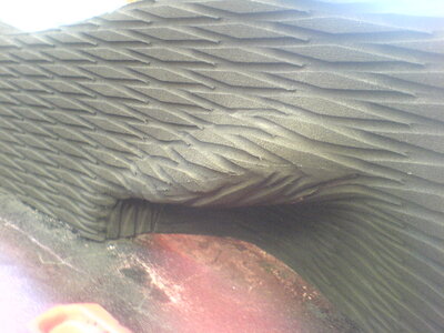

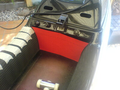

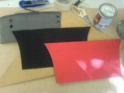

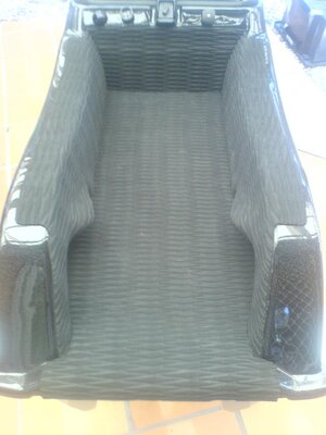

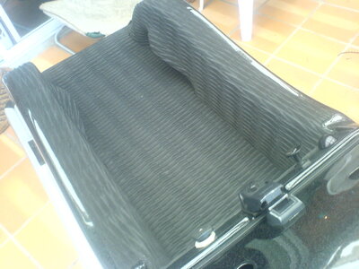

Spent this morning installing the mats. I made my own templates and cut the mats from a blank. There is a layer of foam under the base mat and dash mat.

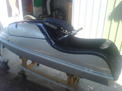

I took these pics with my phone so the quality is not great

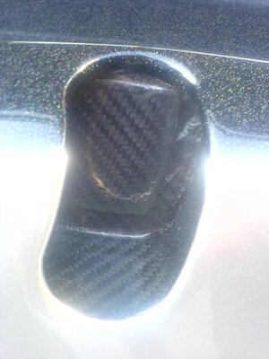

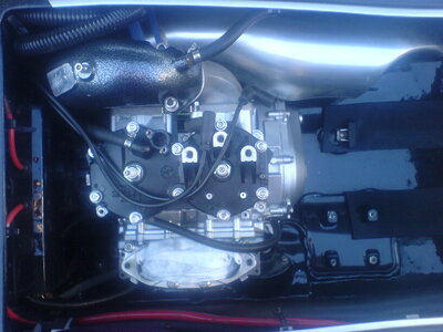

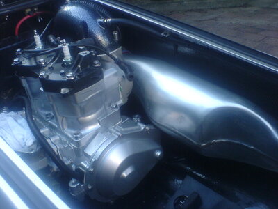

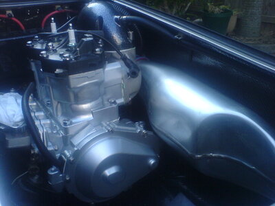

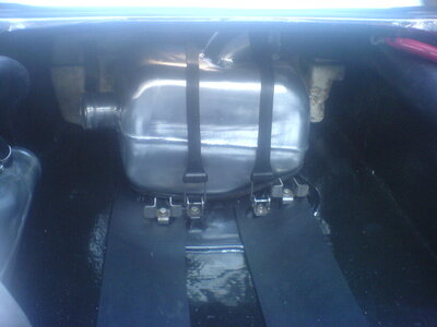

Here's some pics under the hood. Also one pic of the hand holds.

hey slug, ive seen other guys put that curve on top of theyre rails. if u dont mind, how did u go about doing that? id LOVE for my SJ to have that. but im not sure how long it takes and what to do. PM me if u want. thanks
douglee25
m3booooy
South Jersey
You pretty much just pencil the curve on the side of the gunwale, take a reciprocating saw and cut. Then you glass the top end, feather some filler, and paint.
Doug
Slug
Forever Young
I spent ages trying to draw the curve in the side of the ski with a pencil. In the end I took the rubber moulding from an sxr and just traced it. I didn't see what sort of saw Lee used to cut it. It was then glassed from the inside through the cut outs for the footholds. After that the outside was glassed and faired. Those rails are now about an inch thick.

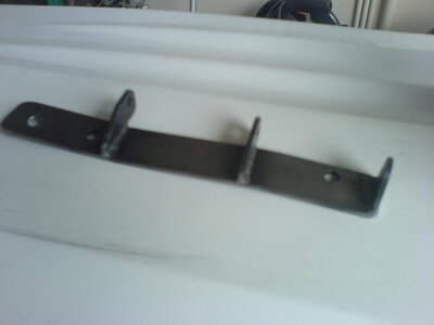

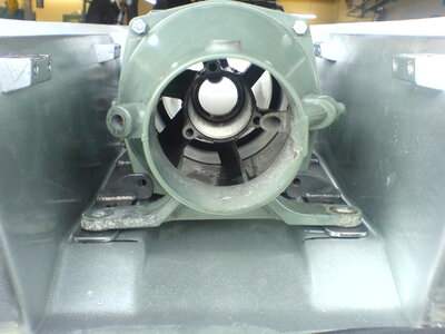

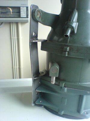

The part that I hate the most is done. The 144mm pump conversion. I took the hull, pump and some photos from tricky to a local guy who builds drag cars and this is what he came up with. The best part about these brackets is if you have to replace the pump all you have to do is grind the wear ring casing a little rather than start all over. The reduction nozzle is untouched. If you drill new holes through the tray at the rear all you need is the front section of the bracket and two spacers. The brackets are now at the powder coaters. The stock pump shoe will stay in for this summer. We opened it up to 130mm for now. I'll make a 144mm pump shoe and open up the intake duct next winter.

Slug,
on the first pic that looks still quite high...
do you have enough clearance for the ride plat using the stock mount ?
Very well done.
