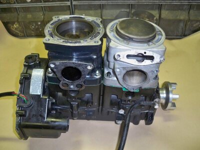

Hampshire, a sled cylinder will not just bolt and go. Alex above can weigh in on this. There are a lot of physical changes that need to be performed, like case work and sleeves. as well as the timing and power valves if equipped. They are not fed water thru the exhaust flange like the 777 cylinder jugs are. it must be plumbed into the lower cases.

Yes, I have those sled cylinder on the right of Joe's engine picture on the 777 in my Octane. Exhaust port timing sucks for jet skis, so the cases are being decked to give a little bit better low end performance. Also needed make adapter plates to run the cooling water into the block, which makes for some funky water routing.
My other Polaris engine has cylinder from the Crank Shop on them. These are the same castings EME use and Power Factor used to use. And you can get the porting specs right the first time. That engine is a beast.
