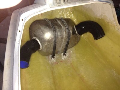

I’ve been researching for a clean way to mount the Ebox on the side of the ski above the PFP manifold. I stumbled across these studs McMaster# 97590A616 http://www.mcmaster.com/#97590a616/=ry3re4 which I believe I could use thickened epoxy and glass to mount them to the side of the hull similar to the way people do die town straps for the different fuel cells. I have vibration dampening bushing to help with the shock when only making ¾ rolls. My question is has anyone done anything like this. Do you think it will hold up or cause other issues? As a backup I could use FHCS bolts thru hull with conical washers but I’m OCD and prefer a clean build if I can get it strong.
