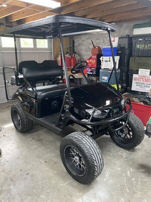

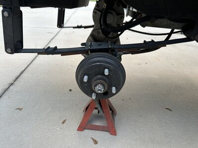

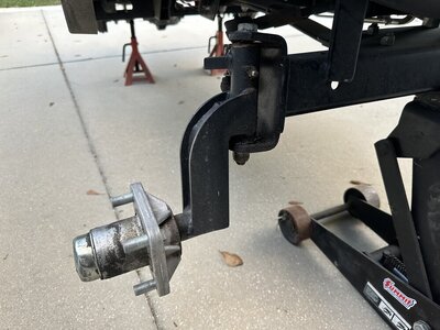

I have a 2016 EZ GO TXT I bought a few years ago. It has a cheap 6” spindle drop but I need to get another lift. One, the ride quality sucks, two, both spindle bolts nuts backed out, wallered out the bottom mounting point and now I need a new front axle. Looked at the Jake’s Lifts but really don’t want to spend that kind of money. I’m going to need new rear springs as well.
Not really up to speed on golf cart lifts so if anyone has any suggestions I would appreciate them. IMG_4556.jpegIMG_2186.jpegIMG_2184.jpeg
