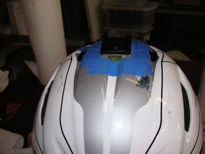

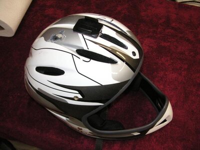

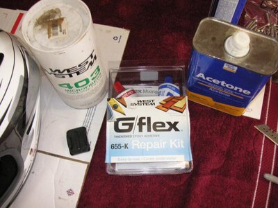

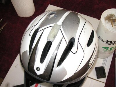

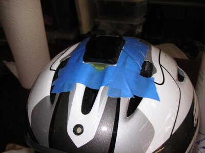

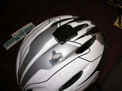

I got the gopro hd for christmas too. I finally mounted mine up like aircraftsalz did, I wet set the 3m mount into west marine g/flex thickened epoxy on my helmet. The g/flex is disigned to aggressively bond dissimiliar materials and then flex to avoid failure during use.
