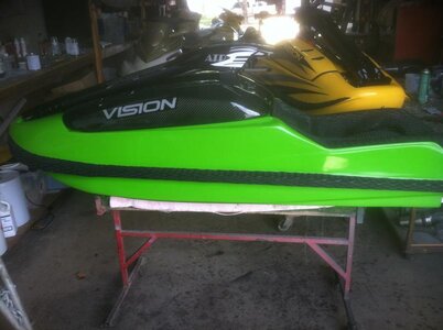

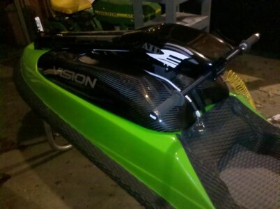

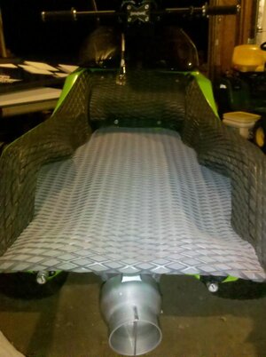

Probably overdue for an update, just trying to stay working on this thing as much as possible. Precious riding weather is passing me by. The pole/steering is just mocked up and sitting there, but getting closer. The ATP bars are 27" wide, I'm assuming you guys cut these down since the stock is like 4" narrower if I remember right?

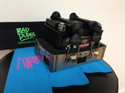

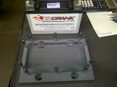

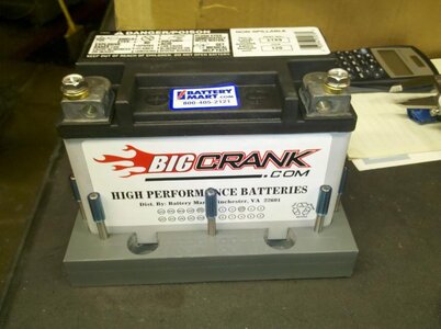

I custom made the battery box to fit my new etx-9, not sure if I like it or not. I used some random 1" thick grey plastic, 3\16" x 2" dowel pins, and some 1/4" plastic airline for a little cushion on the pins. The battery fits in snug, which is what I was going for, but I'm not wanting to break the battery mounting holes in the hull, so maybe I'll start over. I don't know yet, a little more cushion might be a good idea. I used the stock battery pad under the battery and cut it down to size, but I'm still a little hesitant.
I like the way the dash has turned out with the removable front foot hold covering everything up. I think it looks nice and clean. I also think I will like having the ratchet for the hood strap up on top of the hood so I don't hit my face on it.
I think the only thing I might add on the dash is a primer, and I wont mess with that for a while anyway.

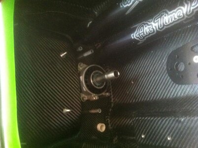

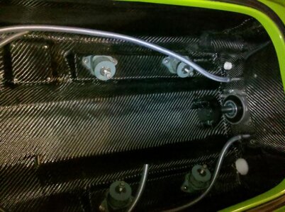

The steering cable install is still an unknown for me, but slowly the unknowns are disappearing one by one. Maybe I'll get lucky and this thing will actually run!?
