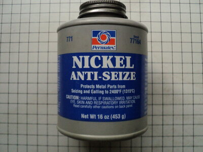

I ride salty (brackish) and saltier (ocean) 100% of the time, carbon hulls, and this works best for me. I slop this stuff on ss imp and shafts when I assemble. I'd stay away from anything with copper or aluminum in it.
