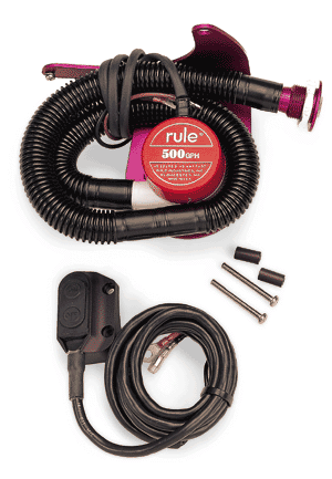

thanks for the awnsers! will run it with the hood of tomorrow, but that bilge you linked isent that the one you have in the middle? or could i move that to the back instead?

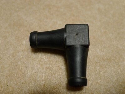

If hull takes on water while off, also check this 90 deg. fitting. It is a vacuum break for the stock syphon. If that hole (#69 drill bit=0.0292") should be clogged, the hull may well take on water while stationary.P1020766.JPG
