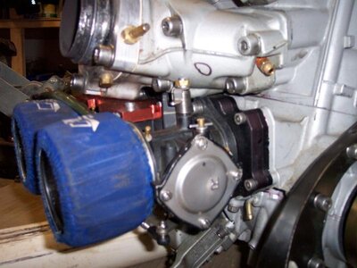

I aimed for 1150° knowing that I was peaking at 1250° for brief periods, (a few seconds anyways). My probes were as close to the manifold flange as physically possible and extended out into the center of the exhaust flow.
You can see in this pic the brass fitting where the EGT probe was fitted in the manifold right above the Spigot mount.
Yeah looks very close to where mine are located. Sorry to clarify i ran my engine in race spec set to around he 1150 mark within about 20 degrees of each other. that allowed me some forgivness on long straights or real tight turns... but never let the engine go past 1250.
