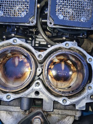

im sure paul will ship to you. he also knows the tnt pipes very well so he will also be a great source. in fact, i decided to have him do my engine work specifically because he knows the tnt center bleed pipes and even runs one on his personal boat. i had him modify the porting specifically for complementing that pipe. i also ended up getting new carbs from him and had him set them up as well. jetting was spot on, i just had to play with screws and adjusted the fuel pressure with a 80 jet in the return instead of the 70 he included. i recently had an oring on my ada head melt (sand clogged cooling lines at the beach oke afternoon) so i pulled the head for the first time since i started running it and the piston wash looks perfect. the service "after the sale" has been excellent as well. one of the fuel engine builders who still rides as well and has probably the most detailed, cleanest, and tuned boats ive ever seen or ridden.
