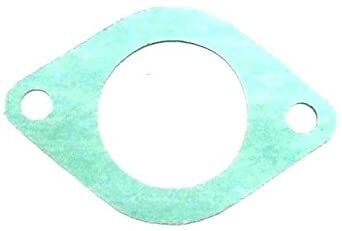

Be sure to replace the gaskets I pointed to in the attachment. They are standard
38mm carb gaskets.
