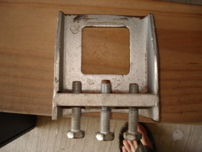

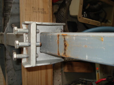

One more suggestion for you if you decide to produce these. To keep the rack from moving(rattling) at all make a little bracket that has 3 bolts to tighten against the receiver hitch from below.

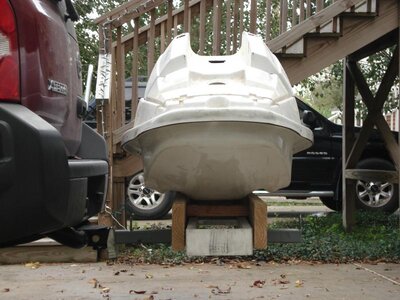

The with the nose pin there isn't that much weight difference. I built mine out of 3 inch exhaust pipe. It is STRONG and still balanced almost exactly with the ski on the truck but without the ski is is heavy on the pin side.
