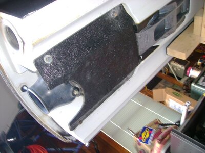

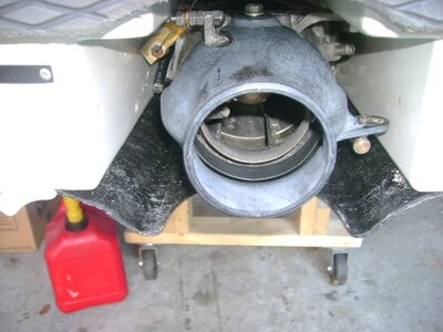

I'm assuming I want it to have some flex. But not so much that it will flex to a breaking point when landing
No, I'm saying even with mine being very strong, on hard landings it still flexes enough that the pump bumps it. You want it rigid...
Finished. Decided not to bother sanding it because I'm only using it for a couple weeks. Came out to about 5.5mm.
Only thing I see that might be a potential problem is that it just barely touches the bottom of the pump. Hmmmmmm. Might throw a couple washers under it.

having the plate touch the pump isnt a bad thing, it will keep the plate from flexing to the breaking point. ive been running my homemade plate for over a year and its never cracked or delaminated. i did have to add more glass to it from beaching it hundreds of times..
That's kinda what I was thinking. Must be better than having it flex to a point where it actually hits the pump with some force. Good to hear yours is lasting so long. I have access to a carbon mold so I might lay one of those up sometime. Just didn't have the time on this one.
