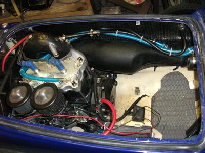

Mine has lasted a full season without any issues in 100%salt. Looks just as good as it did at day one... It must be sandblasted very well to get the powder to stick.
You might be okay with the high temp black but the chrome powder coating turns grey almost after the first heat cycle IMHO.
The ceramic coating is more suited for high temperature applications and it helps to provide a thermal barrier keeping the heat inside the pipe for more HP.
