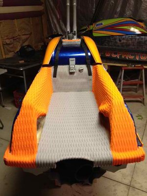

bolt them to pole bracket and get a jetmaniac rachet strap and drill threw bulkhead

I didnt do any drilling on my RN for the hood straps. Attached front of straps under the clips that hold the hood and the back to where the bottom rivets were that held the plastic cover on the bulk head.

i would keep the stock latch and use the wamiltons bungee straps...you will be out shredding while your friends are fumbling with their ratchet straps...ive been slammed so hard with those straps and havent lost a hood..cant say the same for other companies hood straps..
