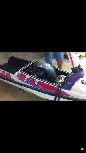

Will a riva freeride pipe fit in an Fx1? Short answer: yes. But it does require modification to the hood lip area and the liner of the hood. It's very tight, but it should work!

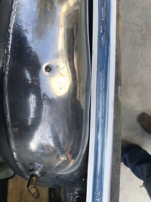

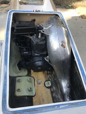

Fits like OJ's gloves. With everything bolted down and aligned it gets pretty tight. I ground the hood seal lip down to nothing and dented the pipe more but is still rubs barely. Coming up short on a few right handed rolls should give me more clearance. Hood liner will also have to be modified.

That's going to vibrate and buzz like a m'fer, you need more space between the hull and chamber. Also, these pipes RIP, I run them in every ski that they fit in.

I'm hoping I can dent it until it doesn't. Here's a better pic. It only gets close in the front. I was able to get the turf in there so that should help. Hood clears now too. Definitely not a bolt on pipe for an fx1.

Are you going to leave the turf there? Is it glued to the pipe?
