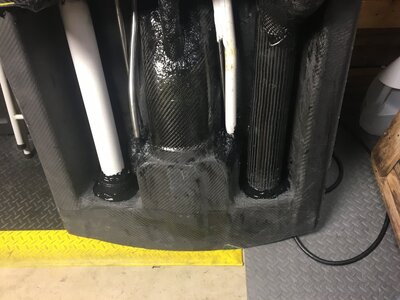

Pic is of my circus build to show that there is some room for foam. There is two pieces of carbon with a 1” wide piece on top that yet to be epoxied into it. l think structurally it’s solid @Jr. And knowing a superfreak, it is gonna corrode parts after a few years and it would be dick to have to clean all that foam out.1690503245883.png
