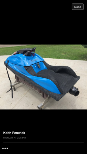

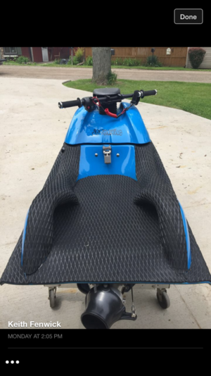

I bought a Brawler last summer and it's awesome! But the foot holds are huge! I wear 10.5 shoe size.
What's the easiest way to make the footholds smaller other than cutting it out and replacing it with a smaller foothold?
I was thinking of just adding more padding under the turf?

No need. Rough the turf up good, Add more padding over the turf and then turf over the extra padding.
Sent from my SM-G920V using Tapatalk
I added extra padding under the turf on the bottom the last time I did it but still wasn't enough I did exactly what @Roseand said on the top of the holds added another layer of padding then turned over it not a great pic but you can see the black turf where I did it
