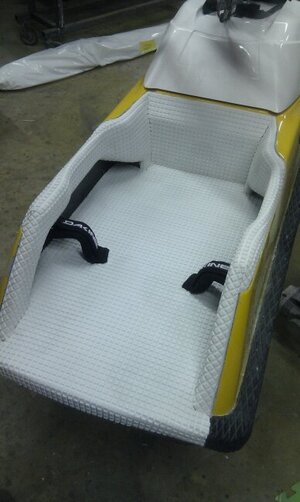

i'm finishing up my hull overhaul and will have a build thread up very soon..... shortened the hull by 3.5 inches, blended tubbies, totally reshaped ssssuper wide tray and adjustable footholds. And the iceing on the cake is this was all done to a 08 hull. Its gonna be awesome in the surf to say the least!

PICS!

yes. 5200 the $hit outta the inside. Also used liberal amounts of industrial grade 2 part epoxy and glassed over. All work done inside the tray because if you want to be sure its all good it has to b done with the tray cut out. I am also using a custom stainless exhaust tube that has been welded up with a nice 45 to 45 bend because i also lowered the tray and the stock exhaust tube say waaay to high in the gunwale. I also fabbed up some really sweet stainless tray drains. i'll have pictures of all up soon.

These are just two quik shots of the cut and inside layup. (very rough, far from finished) The inside is layed up with layers of biax and carbon, biax and carbon.....for many many layers. Super strong and super clean. But if you like the square look, differant strokes for differant folks.....
