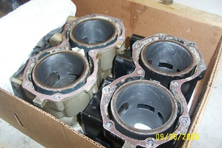

How's this for a nights work?
started at 8, by midnigth we had 4 freshly bored holes...all 1mm over
EWOK is the man!!!!!!!!!!!!!!!!!!!!!!!!!!!!!!!!
everything chamfered, honed and lubed up.........all done, in-house :cool2:

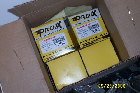

hell no.........just need pistons in hand, and a little motivation never hurts....
we ordered pistons on thurs, had them tues...bored tues night, motors to be assembled tonite!

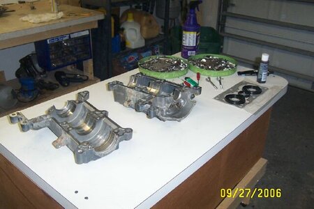

went to assemble motor......on my BRAND NEW sbt crank found that the STOCK locater pins on teh cases are TOO LONG for the sbt bearing locator holes....
most specifically on the PTO bearing...however, the very center bearing was too long as well....
Ewok and i worked about 3-4 hours with just trying to get the crank mounted properly in THREE different sets of cases.......
so, after we stared at each other for awhile....we figured that this at least was the reason that the rear seals blew out when we assebled this motor 3 weeks ago...
E and motosurfer packed up at 4am this mornign to head to sbt....
I have pix and will upload soon..........
talked to motosurfer this morning....SBT's respnonse were that all or most are like that, and that all or most of the cases will require the locator pins to be shaved.....:rolleyes: :bs2:
we did it...but I dont think im cool with that..
:261:
oh, we also had numerous yami cranks lying around which ALL dropped into the cases like butta

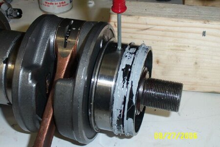

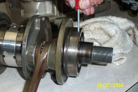

the OE holes on the bearings are SOO much deeper....you could see that even before we mic'd it..
here's the pix........
look at the tip of the screwdriver.........there is at least .5mm more depth in the OE crank......
the sbt crank is the one with the yamabond on it....

sbt crank problem!!!
Just following up on motor status! The center bearing divider, or fropper???as sbt calls it(new term to me?)was .0035 bigger than the bearing was. Know wonder why the crank wasn't going into cases all the way. Didn't we learn this in kindergarden, The square peg does not fit the round hole!!!Waiting to see what happens??E.
Interesting. I've never of such an issue before. I guess you can't chuck it up in a lathe, huh?
Doug
you could, if you had the proper equipment to tear down a crank.....
it blows my (our whole crew's) mind....
you can set the crank into the cases.....see that there is a visible gap between the locater pins and bearings....
then the crank will actually rock (teeter totter) back and forth because the casting is too big......
we sent the cases and crank to sbt (on their dime).....they told us the tech's had "no problems putting them together"
