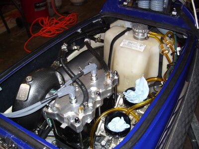

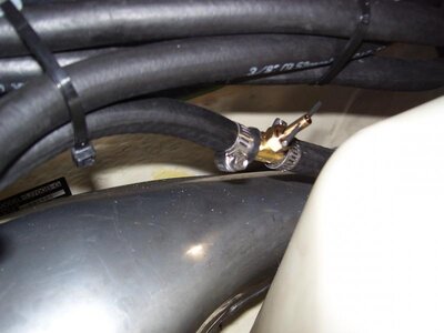

I said f it and picked up my own flow controller from home depot. Only cost 5 bucks. I think my jetworks valve is missing something on the inside. I don't know. I want to try it out tomorrow and I don't want to wait for a new valve. I guess the weather is suppose to be windy tomorrow so maybe not.
View attachment 150398 View attachment 150397
That is acting as a restricter, not a fcv. Most skis end up needing both on the stinger.

Well I took it out for it maiden voyage today. There is definitely something wrong with it besides the flow controller. I get the feeling I'm going to be taking all back apart.
I was under the impression this was tuned and ready to go. The low end was rough the whole time but it cleared out in the mid range when I feathered the throttle. After about 15 min it started running really terrible no matter what I did so I headed back to the dock in case some thing bad was about to happen. I emailed art and I will try to call him tomorrow. The good thing is that we should have clear sunny skies for the next few days. That should make water testing a little more pleasurable.

get rid of the crappy restrictor and put the flow valve on and check it the way tzane told you too. you are going to melt or blow cooling lines with that 5.00 POS!!!

I'm pretty sure I'm not going to melt any lines or couples with my pos restrictor. Like I said there are other problems that need to be dealt with before I worry about my pos restrictor.

when matt helps you i am sure he will throw away the restictor, it works nothing like the flow valve. some people.......ask me how i know you will over heat over restrict and blow lines. actually i will tell you, because some idiot that use to ride with us did the same thing and instead of buying one off my buddy, he use the same restrictor and f-ed his :):):):) up pretty quick. not saying your an idiot even though you ditched the flow valve for a 5.00 restrictor which is a dumbass move.
