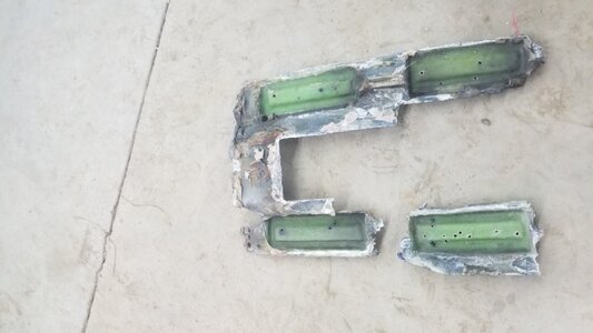

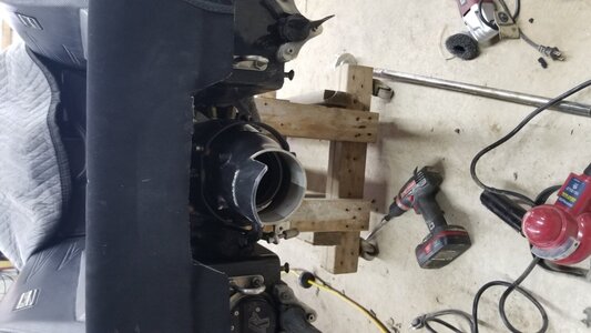

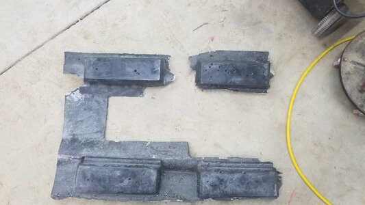

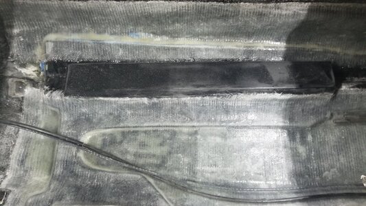

So things have been very busy lately, I have acquired my "new" skat trak 145 14v pump, received parts from blowsion, finished the turf, and in an unfortunate turn, I have begun to remove the bedplates. Earlier this week I made a trip down to Paul Lehr's house for his advise and what our original plan was is that I was going to cut out the cracked and lifting sections of the bedplates and we were going to lay some carbon fiber to reinforce the sections we had cut out. So I started cutting and when I got about 3/4 inch down the crack the bedplate became hollow. Turns out the whole bedplates are completely hollow except for an about 1/2 to 3/4 inch strip of glue around the edges. With this new information, I called Paul and our new solution is that I will remove the bedplates, which isn't too bad so far, and we will fix all the cracks and reinforce and fill in all the void under the bedplates. I will post pictures tomorrow of the current progress.

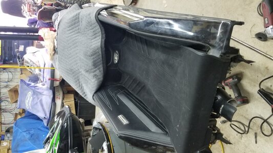

O yes, doing the turf on this thing was a nightmare. I used two hydro turf 2.5"-48"-1" lifting wedges, 1 1" kicker, 1 2" kicker and a sheet of underpadding. I hope i do not have to do it again for a while.

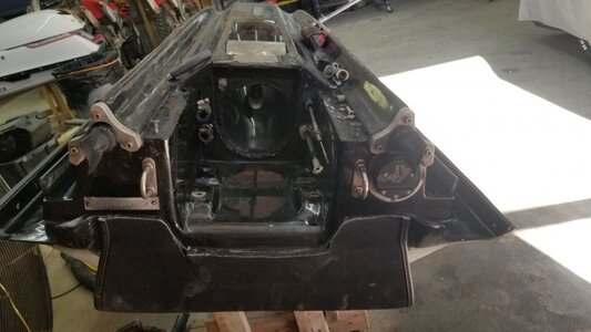

Can u share a picture with the bottom hull? to see the shape of it? thks
I will take a picture tomorrow!

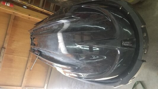

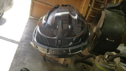

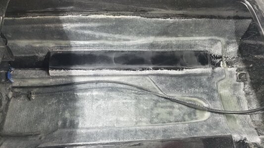

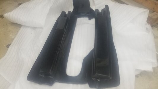

It has been a minute since I've posted, I've got quite a bit done since the last post. To start I got the old bedplates fully removed and it was the right decision to remove them because they were in pretty rough shape. I finally received the new ones from kommander which will allow me to put the 1500 relatively easy. I have prepped the hull for the most part. it still needs a little bit more sanding. The new problem is that the bedplates won't actually fit in the hole in the top deck, so what I was planning to do is cut the bedplate into two pieces. I don't think it will affect the integrity of them too much but it's going to be the only way to get them in without splitting the top and bottom deck. I am also thinking of cutting off the carrier bearing housing off the new bedplates since my hull already has one that was a different piece from my original bedplates.I'm thinking of doing this because to get all the tubes and stuff reglued to the housing would be a real b**ch and I don't know if I could get it to seal properly. The original one is not broken in any way so might as well keep it. I got my new pump installed and enlarged the pump shoe to account for the bigger pump. I got the trim and steering all set up. The only thing I'm waiting on now is the glue for the bedplates. After doing some communicating with some hull builders I have decided to go with Plexus MA310.

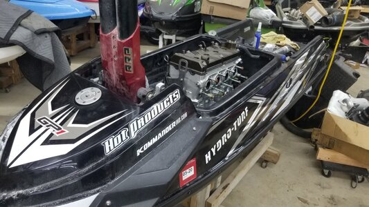

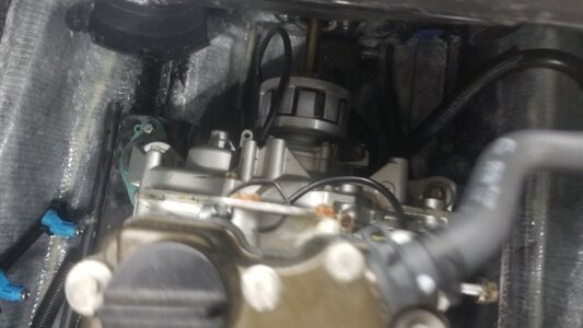

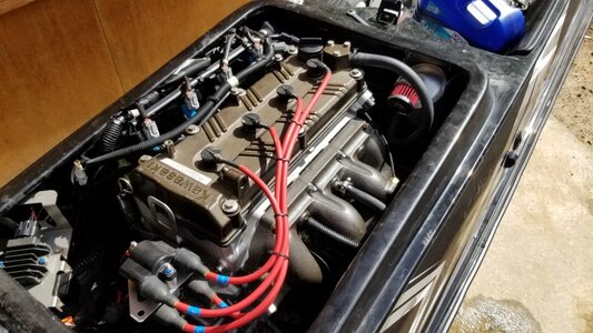

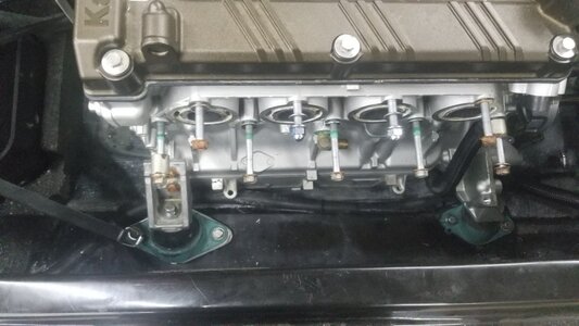

It is done! Well it's been done for like 2 weeks I just forget to update this. Since my last post I have glued the bedplates down with the plexus then filled in the voids with epoxy with 404 filler. I got the motor aligned which took like 3/4 of an inch of spacers in the front to get it reasonable. The exaust was probably one of the harder things for my dad and I, we used a 3" to 2.5" stainless collector for the weird kawi coupler deal then ran a "straight" pipe out the back. This would have been pretty easy and pretty if we had a tig welder but we made it work with the mig. Everything else was just a matter of bolting down. I've took it to the lake multiple times and it is pretty fast and extremely loud. I've GPSed it at 64mph which is pretty impressive since it is more fuel efficient than my brothers squarenose and my other brothers fx1.

If you are not running a waterbox or "trap" setup, you will eventually suck water into the motor when you go to start it. I found that out the hard way on my 15f build a few years ago.

There is seriously zero room for any sort of waterbox in the hull. The ski does have a flapper on the end which will prevent alot of the water from rushing into the exaust when sitting still, Plus the back of the exaust is 3" lower than the front plus the height of the manifold so im not really worried about water getting into the motor when sitting still.
An 8mph gain compared to the earlier Stock SXR 800 Engine which did 56 mph already.
If the SXR 800 had been built to a Pump Gas Limited, you would probably have been going just over 60 mph without all the noise.
Either way, good job doing the conversion.
Thanks! 8mph is quite a bit, no? The 800 might of been able to barely break 60 but hit would have still handled weird due to being too light for the hull. There is still plenty of room to gain on the 1500 as it is still bone stock. I am going to have a fellow racer install a 93 octane tune on it and pitch the prop correctly to get the correct rpms.

Keep an eye on it, the concern isn't if it will back up the exhaust when the motor is off (that is a possibility but since you have a flapper on it you minimize the risk). If you have the motor off and there is any water in the exhaust pipe at all (even from the water injection ports), the motor will suck it up the exhaust manifold and it will lock the motor up. I had it do that with the ski on the trailer with the exhaust barely in the water.
I spent a month or so trying to figure out what the hard start issue was on my ski before I pulled the spark plugs and found water in the cylinders. When I added the waterbox back on the ski, it fixed the problem. I confirmed that it was reversion by running the setup on the stand on the hose.
You may have less of an issue with the stock cams, I was running zx12r cams at the time.
If the ski gets hard to start, pop the spark plugs out and crank it over.
