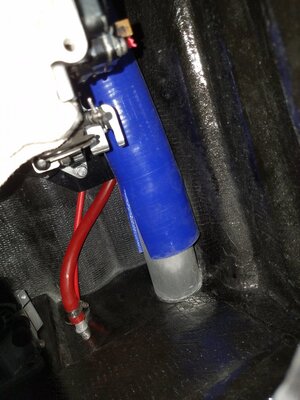

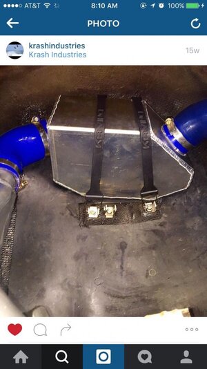

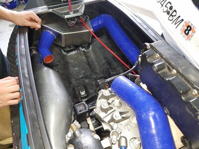

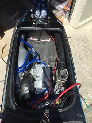

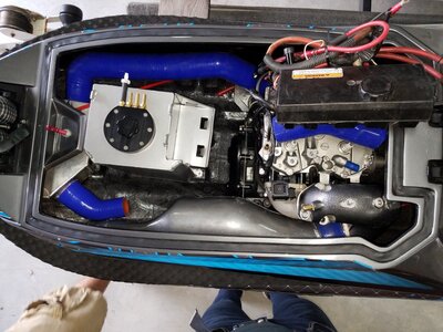

I feel like a 'tard, but wherever I put the waterbox it seems like something won't fit. Exhaust hose too short or B pipe too close, etc.
If anyone has any, could you post your 50 Cal waterbox/engine bay setup? It would be much appreciated!
Pa
I flipped mine 6 times before deciding what was up or down, with breathers in it is a VERY tight fit

Edit: oh damn looks like it is backwards lol. I did it with the back slope like the front of the hull as putting it in there vertically put a lot of pressure on the hoses. Will have to revisit. thanks for the pics
The long right side exhaust hose is too short. Someone cut it too far up. Pisses me off.

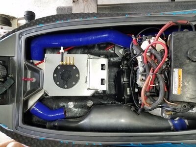

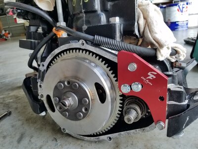

Good progress today though. New ADA coupler installed, CF flywheel tool made that a freakin breeze. Engine and exhaust are just chillin in there for now for fitment.

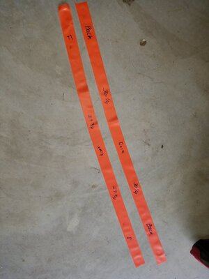

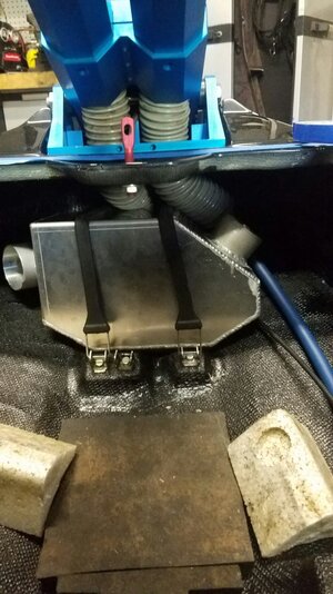

Measured how long the straps for the fuel tank need to be when stretched, front is 29.75in and the rear is 30.25in. Looks like I'll need to install 3 UFO inserts for the tank.
Still not sure how best the CF ebox mount works. Seems like some .75in spacers on the outer two holes and just bolt into some UFO inserts would do the trick. It might be for sale soon if I don't use it. I didn't realize it required you to drill through the hull to mount it and I don't want my dash full of bolt heads.

The box is backwards lol
It figures lol. We must have shoved it in there all kinds of ways. I eventually fell on the way I have it in the pics because the back slant of the waterbox fit the same slant of the hull rocker. But the pics you and @ajmps1 look right. This is my first build ever so the mistakes happen. And that waterbox is super ambiguous haha. Thanks for clearing that up guys!!

Nah it's not your fault the Krash box is bisexual. I have a buddy with one correctly installed backwards in his rickter lol it fits perfect. Most waterboxes are pretty clear cut which way they go. This on isn't
