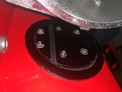

I was wrong about 1 thing I said In a previous post,I didn't went with a tube to the firewall. If u drill a hole in the back of the ski u will hit another wall in the hull about 20 cm there is a block and 90 turn for the water true pumphouse scupper, the rest of you ski is a open tunnel so no tube in there. in previous post I was mixed up with my raptor.and I don't think the blowsion will fit the predator or u have to make more adjustments its possible.but now if I think it over is thrust the best option
The photo is from pumptunnel scupper u see the tube I put true and refoamed it with 2compound special foam
