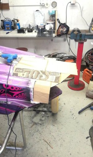

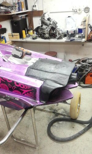

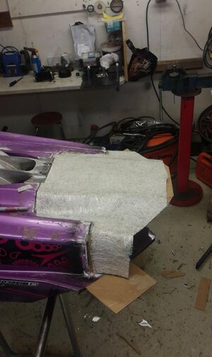

I did see that, I want to go further and actually move the entire pump assembly back. The distance between bulkhead and turn nozzle IMO is too short to effectively just lengthen the hull bottom. I want to move it all back.
I would probably mold the insert then quick epoxy it in place (like a tack weld) just to hold it until a nice bead of six 10 can be applied across the Seam. Then come back and fully reinforce with epoxy soaked cloth. Just my 2ct
