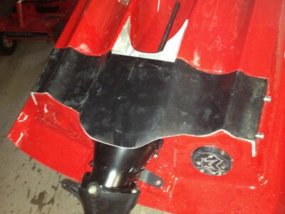

A bunch or seasoned riders rode the Brawler at Flat Water Friday and decided to cut almost flush. It was perfect for flat water if you are going to do BF etc. For surf an additional 1 1/2 -2" is recomended. It all depends on what you are doing with it as well. Ride plates are for experimenting after your in the water. Leave it longer and cut to your liking.
I hear what your saying but.... Too late
