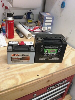

Dslicker got me this battery. Its a Deka.. http://www.eastpenn-deka.com/
http://www.eastpenn-deka.com/default.aspx?pageid=510
ETX9. I think is like 6 or 8 lbs ?
I tried a little 4 lbs walmart type, but it would not crank over my 5 mil with 210 compression..
Brent hooked me up with this, and never looked back.. THING ROCKS..
Holds charge, cranks with 210 psi and water in it...:1zhelp:
I recommend. Thanks Brent ! :headbang:
Listen to that bark up.. and im not sponsored by them either..
