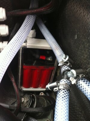

The earthx need to be sealed around the terminals. I only sealed mine along the seam, which I guess isn't really needed, I didn't think to seal around the terminals. Mine lasted a few months until I had my starter go out on me in havasu and I had to swim it to shore which took about 20 min. My trim tube was letting water in, flooded my ski and I must have got water in the battery because at the end of the next day at body beach my battery wouldn't start my ski any more. I sent it in for warranty, the inspected it and got back to me right away saying it failed due to water intrusion. They sent me a new battery with no hassle at all and it's been good ever since.
I've had some experience with the earthx battery. Ordered one right after finals because I liked the looks of the ones I saw there. The first two I used were the "C" case model and they both failed fast due to some some major water intrusion. After inspecting further, you could see right inside the battery at the seam. One side definitely wasn't welded up right. They were quick to tell me I must be doing something wrong as they had never seen them die due to water ingestion and I had killed two so quickly. After they received and inspected them they sent me a replacement immediately in the "B" case, saying they they had found a problem in the way they were sealing up the "C" cases and were working to fix it. They hoped to have new ones ready by spring.
