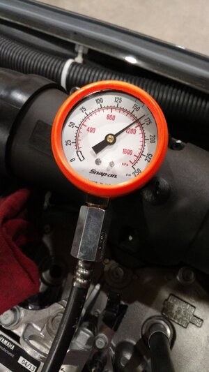

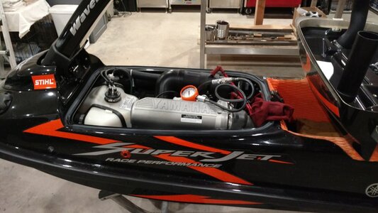

Hey, gent's, just came across thread. I'm the old wealthy guy with the 13 SJ for sale...haha!!! thanks for kind words
So just to set record straight, the comp number is what I pulled off my snap on gauge, maybe closer to 165psi, Maybe it's off. I crank till needle tops out at open throttle cold. It is an overall nice reliable ski..
And...I'm not 50 but close at 47 not very wealthy but rich in life here in Montana!!
Cheers
