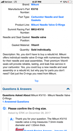

I just ordered 100. I let yall know how it fits and the size.
The size is: 7.5mm inside,10.5mm outside- 1.5mm thick. Since it is for a static application, a rather "soft" compound would be indicated. Since there is a bit of ethanol in the gas, additional chemical resistance would be nice. I just "repaired" a set of 38's for a friend, came out of a running-older- ski that would let the crank case fill with gas when parked/stored. Needles looked as new, seats were so stuck, I had to drive them out from the other side (corrosion). The o rings were half (!) eaten away and not sealing, so.......
I strongly suggest to use something better than a plumbers (no offence intended towards the low cut jeans crowd) o ring, maybe this: mcmaster. com 1295N157
Thats the size I ordered. I got the fuel\oil rated orings medium hardness we shall see.
