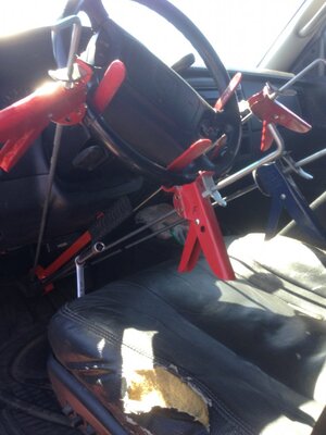

Also considered the sticks that hook the steering wheel but if rear tires leave the ramp and the winds blowing the truck could move sideways releasing the brake stick so that's out...

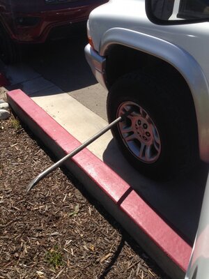

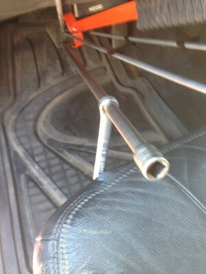

So I came up with this stick, it applies full hydrolic brake pressure manually. Will hold truck in gear with no e-brake applied. Once I've backed in with my foot still on the brake I install the brake stick. I slotted the knee bolster panel below the steering column to hook it too. Little bit of turf to help find the slot lol. Works great. Later model
Vehicles can have knee air bags in that panel so be careful.
That deep second deep spot didn't applie enough pressure to hold truck in gear so made a shollower one so I have options

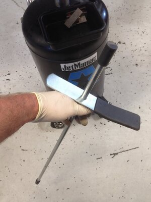

Goggle brake pedal depressor. Common mechanics tool, I have a few variants of it. The one that hooks onto the steering wheel is nice. Quick and easy to set and release.
Or 4x4, brake set, park (auto) 1st gear (manual) and shut it off. But if your exhaust is in the water leave it running for good measure.
if you ever worked on cars doing wheel alignments, there is the tool to keep the brakes applied while you do the alignment. its just a long round rod with another flat piece with a hole that the rod goes thru. it binds on the rod and wont slip. fully adjustable and the flat piece pushes on the seat below the steering wheel.
