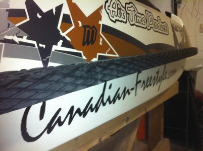

i have gotten my tray all sealed up and turfed.. i used 4 layers of 10oz glass to glass my tray back in then i cut out the old 24/7 holds and glassed in the xmetal ones.. Check out the size difference in the picture that i have one of each installed. I really like the big holds so hopefully the xmetals work great. This is the first ski i have ever turfed, big thanks to Yamacore for the how 2 guide...
