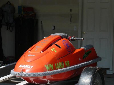

Some pics of the ski as it currently is configured.
