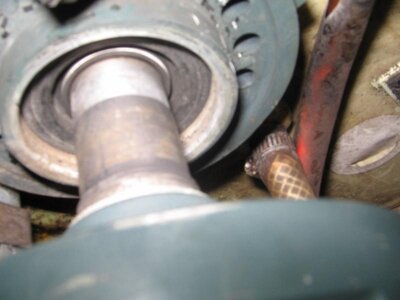

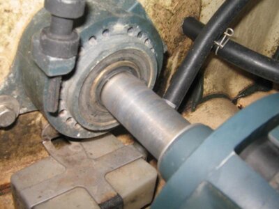

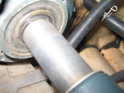

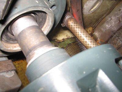

How do these look????
do this look ok??

ive been told they really dont need grease added, the grease used during assembly is enough to last the life of the bearing and seals. its a sealed bearing so no grease is added to that.
those pics dont say nothing
