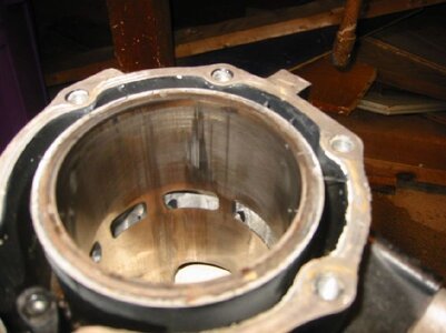

well i took off my flame arrestors today to find that my throttle plate is missing a screw :banghead: i know it was there before so there's only one place it could've gone. i took off the intake to see if it got caught up in the reeds, but there's nothing there. compression is still good, and it ran awesome yesterday, so i don't know what to do. is there anything else i can do short of tearing the whole f***ing thing down?

That's a tough one... on one hand it seems to be running well long after the screw fell into the engine... on the other hand, if it's still in there it could cause major damage.
I'd pull the engine and look around inside the intakes, you'll be able to see it or hear it.

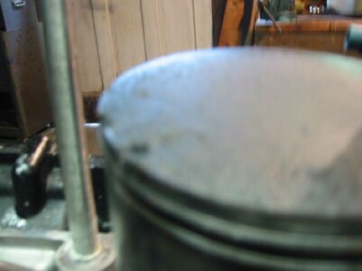

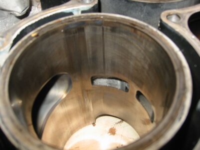

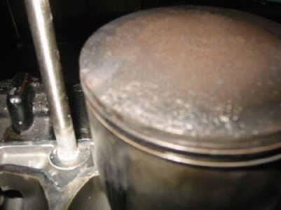

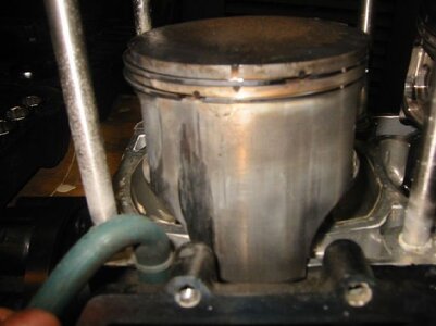

well the results are in, and major damage it is....

i still haven't found the screw either. i can't see it in the cases, but i haven't taken them apart (and reaaaaally don't want to) if it messed up the top of the piston like that it probably just went out the exhaust right?
also, how do i know if it's too bad for just a hone? it's already at 83mm so i don't really want to go any further, and if i just hone it i only have to buy one piston.

You measured the compression, right? If it's good, just give it a light hone. You only have 1 overbore left.
The screw might be in your waterbox, take it out and check.
well the compression wasn't great, it was 180. this motor should be running about 190-195, but part of the piston is missing so that probably makes up for the difference. i don't know the first thing about honing nor do i have the equipment to do it so i'm just gonna drop by a local mechanic shop and see if they'll run a hone through it for me, and also get their opinion on whether or not it needs an overbore.
i turned the cases upside down and shook em around and stuff and didn't see or hear anything, so i don't think it's in there. i'll look in the waterbox tomorrow though. if it's not in there, does it pretty much have to be in the cases or can it actually go right through the waterbox too?

It is hard to see the fuzzy piston pics, but I don't think that damage was from the loose screw. Looks more like water injestion or cold seizure. I would suggest tearing it all the way down if you don't find it in the waterbox. Also you should peen the carb shaft screws so they won't back out again. Have someone clean the aluminum from the bore and hone it. Have them measure the bores and determine if you can get by with 83mm pistons again. If you are running 195 lbs compression then you better mix in some race gas to avoid deto and more damage. Just my .02 worth :banghead:
i'm pretty sure it is from the screw. if you look at the top of the pistons, there are all kind of scratches like the screw was up there for a while, and the dome has a bunch of scratches and dents too. how do you 'peen' something? i have been running 110 mixed with 93, so i don't think that's a problem. i'm running wisecos right now, and i know they need a pretty precise clearance, so should i go to pro-x after this hone or will wisecos still be alright?

well i just got back from the shop here and he honed it for me and ordered a new piston and new rings for the old piston, so i'll be ready to ride again this weekend. :biggthumpup: he said the clearance (before hone) was 7 thousands, so that's not good, but i should be good for the rest of the year at least. the scratches and holes from the screw have carbon deposits on them already, so it looks like this happened a while ago. it looks like this is why it's been so hard to tune this thing all year. :arms:
