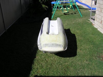

heres me build, not finished yet but getting there slowly..... hull was a freebie and so far cost me about 300 in glass,resin and misc. Ive made the tray wide and recessed where the foot holds will go... More nose rocker and reshaped nose... hood has got a new liner and also been lowered and reshaped....2.5 inch off the rear angled cut...footholds have been shaped but not glassed yet, the photo shows the rough position.

I like the foot hold. Look at the BOB hold so you get an idea of what they are doing. Yours look very similar. I love the big tray.

Ive stood in the tray on the grass and it feels so right, cant wait to ride it!! Yeah the bob holds are great ! ive made mine similar but im not gunna make them adjustable, thought about it but nah simpler and stronger this way.

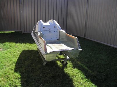

I'm also going to make the tray walls a bit more forgiving as they are Thin and could do some damage when falling off. I'm thinking some sort of a pillow top with either foam or padding .
yeah that souds like a good idea, mine r pretty thin to but has a nice flat are round 2" wide im going to add some plush foam, This is where im at on my nose still need to work on the new bondline its crooked, but im likeing the overall shape.

Lookin good! Yeah take your time get everything as straight as you can, saves headaches later on
