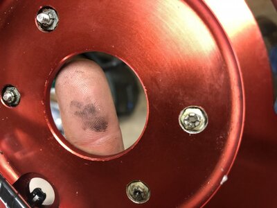

54575B4F-B357-434E-A339-F7FB18A21F8B.jpegCF635511-7275-4191-BA61-67B14BF78E84.jpegpulled the plate off and you can obviously see this was a single pick up plate converted over, one set of holes is missing anodization. Would explain why the timing is off lol, I’m going to try to redrill but I’m not sure how much I’d have to move the pickup to make up 3*
Update: adjusted pickup by close to 1 1/2mm and each cylinder is firing within .01” of eachother
