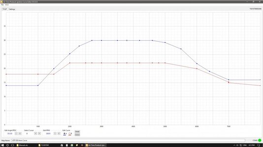

Haven't ran it yet but here are the two curves ATP set me up with. I've been told its a little conservative but I'm okay with that lol.
Rotary switch to bounce between them both while riding. At the very least if I ever want to test a curve I keep my existing one as well. I have the lead secured in my ATP Billet housing, but if I was running a stock ebox I'd have the lead right by the fuse access.

That's the same as I tried last weekend. Only thing I have done is bring it on a bit more agressively.
Started at 15 deg then straight to 30 at 1500rpm then left the rest alone.
Cant wait to try it. I went out nearly a turn on the highs when I first tried so upjetting it a tad aswel.
