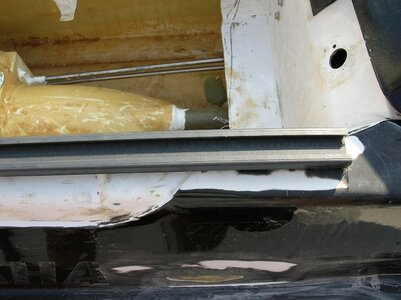

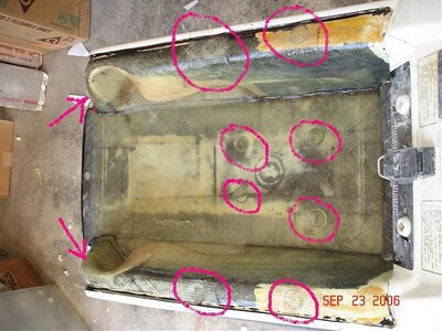

I only have a picture of the holes glassed over.
I did drill a few too many but I had no idea how that foam would spread so I went a little crazy with the hole saw. The holes were the size of the funnels I bought (3/4").
Here's the picture where I circled the holes plus the two in the rear that you can't see I marked with arrows.

Boris
The Good Old Days
That would be ideal I think.
You can tip your ski up or down or side to side to spread the foam out thus you don't need as many holes.
The 2 in the back I filled last with the ski almost vertical and the foam spread all over quite nicely.
6 holes should be more than enough.

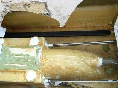

I haven't made much progress I'm waiting for my foam and glass to come from uscomposites and I just ordered some 3/8 Stainless tubing to add another coolant line and replace the 2 stock aluminum lines since I'll be using the ski in salt water.
New York

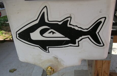

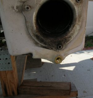

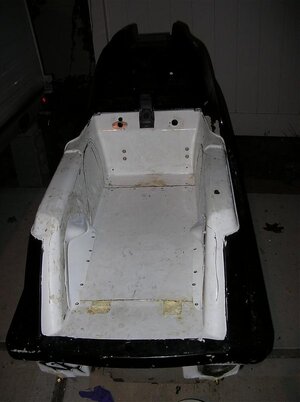

Well I finally got a little break from the school work so I installed the new stainless lines and some drain plugs. I am going to be using these two pieces of plastic (actually slides off a snowmobile) in the channels so if water gets in it can go down there and be drained out.

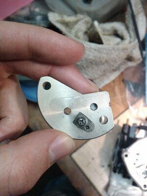

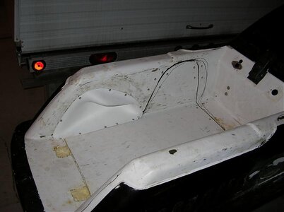

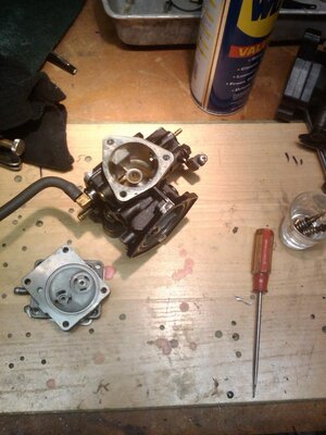

Well almost 3 years later I'm finally back on this project...my life was on hold due to stupid dental schoo.l I had zerio time / energry to work on this. Anyway I started rebuilding the carbs tonight. The hull is almost ready for paint I just have to wait for the weather here to warm up. More pics of hull to follow.

New York
anyone know if both carbs should have the little clear plastic piece bc it was missing in one of the carbs
