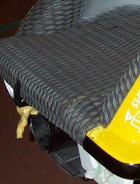

I would fill in the area where you cut out around the stern hole... man you want that pad it up good there, trust me...
mine is like this:
just cut a slit where the hole is at and slide the rope through at a 90 degree angle out the back... it works good and you get to keep the kicktail, not to mention you will have padding where you need it bad

fyi - it's in the original stern hole, just routed through the padding out the rear...
just do the padding and turf, then make a hole through the rear of the pad up to where the hole would normally go through the pad/turf and then stick your finger up through the hole and clear enough room to feed the rope through
that is my rear loop holding my ski.... he he he :bigeyes:

Do you have any problems with turf pulling up around the rope?
nope.... no problems... use a thick rope to fill the hole good.. that way you won't have water spashing up through there... hell, put a piece of duct tape under there if you are concerened...
what you dont see is the pic of nick sweating BULLETS!
my sternloop is done about the same way as yours GP......

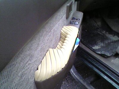

You are slower at turfing than me :hitwithrock: I never realized how much I use my heat gun and how much my hair dryer sucks until this past week. I gave up on Dave's ski last night but my arm rest turned out okay :biggrin:

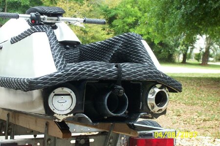

I haven't had much time to work on my ski much because of the jobs I've been working on. So, I decided to institute what some might call a work exchange program.
Beachjunkey finished up the turf, glassed a crack in the hood, and modded the stock hood a little. I'll get pics of the hood later.

Fathom then went to work and trimmed in the turf and detailed the motor like only he knows how. Joel also tightened up the steering and took care of a couple other details.
