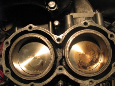

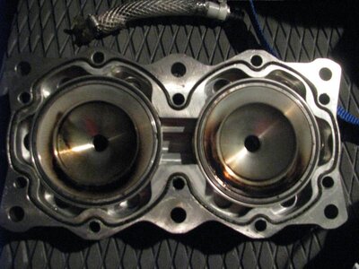

so i have about 25 gallons threw it and decided to take the head off to check things out. turns out one piston is leaner than the other. so i double checked the carbs and one was a 1/4 turn off on the low.... which is totally my fault. but thats why im checking it out, this is a huge learning experience. i also had some problems with the exhaust overheating from the waterbox back. after pondering for a few i decided that i wanted to change my water routing a bit. tomorrows run will tell if it works better. i think im going to end up cutting down the spring in my fcv to get it to open up earlier.

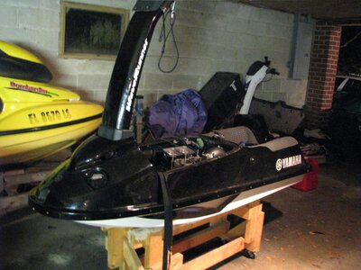

there is a pic of my sj for you suzi!

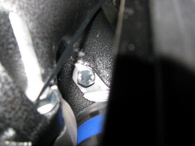

and yes thats my middle "bolt" on my b pipe... i needed it closed anyways lol
