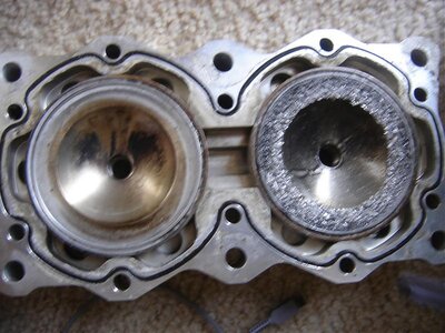

yes new crank got in august ....was running like a champ too.
noup was flushing at mid rang and just stoped
gump, im curious to see your pistons pics. do your sparkplugs have any rust on them? what kind of head? im thinking water injestion through a bad o ring or cracked dome.
did you have the hose pressure like a morning piss? or did you have it on like a fire hose?

no rust ...ada head .... no water in the case... o ring looked good when i took apart

From the look of the domes...you had a crank bearing failure first (possibly a pin bearing) and then broke the rod from too much debris floating in the motor and tying up the piston in the bore from what I see. You'll know when you get the crank out for inspection...Sometimes if you get the squish clearance too tight and kiss the piston against the head can cause a rod bearing failure. What oil were you using? What ratio you mixing at? Have you been riding in salt water a lot and got any in motor? One main cause of premature crankshaft bearing failure is water ingestion, so check all cooling lines and fittings to make sure you have no leaks.

no bearings missing on the crank...klotz oil 40.1 i was not lean 100% sure was rich so rich that i had black water coming out. and i had use fog oil day b4
no water in the crank also no sign of rust.
still think was the bearing on piston ...but dont know.
and new hot rod crank on august 2006 so...i guess just a unlucky mofo

What pistons were you using; R&D or Kawi's Which needle bearings were in there? OEM yami's or Kawi's
Inquiring minds wanna know! I have ran flat tops for years and never experienced anything like that!

dunno exactly witch bearing ...but was kaiw's pistons ...tricky hook me up with bearing(so i know was good shiat)
