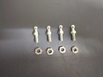

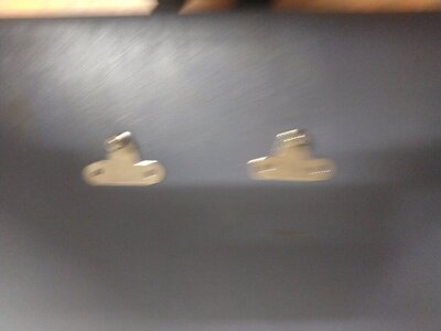

So most of the stuff is finally here, I say most because two of the brackets never showed up, the two that did are not heavy duty enough for my tastes either , basically flimsy Ebay BS , so on to plan B.
I looked through my pile of stainless and ran across this bracket, I can see two ball stud brackets in there just waiting to be freed, and so I made it happen this morning, I still have to drill and tap the tubing for the other two ball studs and I will most likely weld an 8mm nut over the drilled and tapped hole but this should get the door opening enough to proceed with the build.
I will know for sure later today, the trailer is at my house so I will have to wait on the welding till I can transport it to the shop next week.
