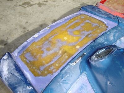

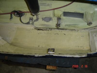

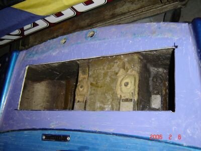

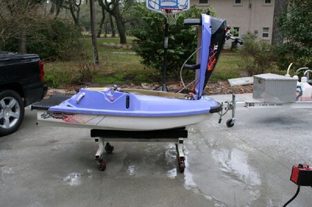

Jerry, I agree don't add extra hardner. Poly hardens faster then epoxy (Unless you use a fast set) The heat lamp will help, but glass needs a slow set time to bond correctly.
I don't blame you for not doing the whole rip open and work, it was a big PIA. Took about 25 hours to do both of the ski's at the same time but I'm done now... Just need paint.
p.s. I just noticed I forgot to take a picture of the inside transom glass work before I closed it up..... F#$K!
