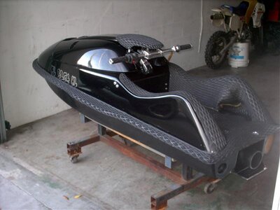

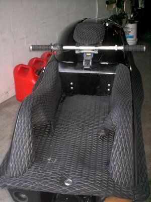

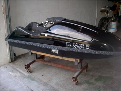

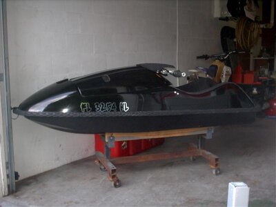

heres my 2007 xjet i picked up at the 2007 daytona freeride, i have been workin on it since april working out some bugs from a used motor i had put in it from another ski:ugh2:
pretty soon i will be changing to an 800 swap but from now this has kept me on the water and having fun:fing02:
HULL:
- 2007 waterdawg kustomx x-jet
-wet laid fiberglass, reinforced carbon/kevlar
- rev foot holds
- one piece xjet nose
- lowered xjet hood w/ holds
- one way home depot scupper
- custom waterdawg bedplate to accept the gp800
- x metal -4 pole
- x metal lowered dual breather pole bracket
- CG carbon chinpad
- waterdawg -2.5 turnplate, bars, and bearing setup
- waterdawg hoodlatch

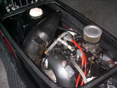

MOTOR:
- 95 waveblater1 61x 701
- 175psi stock head
- protech stock girdle
- single 46 mikuni sbn
- factory bpipe w/ blaster mod chamber and team scream 785 mod
PUMP:
- OEM 144
- worx intake grate
- protech extended ride plate
- solas 13/16 repitched by impros
- new wear ring
- royal flush used stator vein, bearings, and driveshaft assem. :Banane26:
- home bore reduction nozzle
- homemade extended steering nozzle
- homemade steering bracket:fing02:
i think thats it for now, im sure i forgot some stuff but i will be adding later
