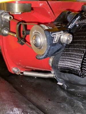

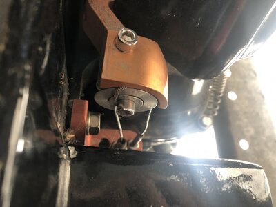

I started having that issue too, on tail landings the nozzle would trim up on its own upon landing, slacking the cable, and getting off the pully...
I put 1 zip tie around both cables at the midpoint between the pully and the cable anchor points.. helps it keep a tear drop shape when slacked
